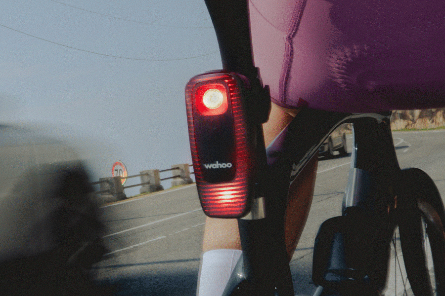

Radar Sensors
ELEMNT integrates with ANT+ radar sensors, including the Wahoo TRACKR RADAR and Garmin Varia. When a compatible radar sensor detects a vehicle approaching from behind, a visual alert appears directly on your ELEMNT GPS display, so you do not need to glance at a separate device or take your attention off the road.
The Wahoo TRACKR RADAR operates on the open ANT+ Radar standard; it is not limited to Wahoo GPS devices. It is designed to work with any ANT+ compatible bike computer, including those from other brands. Find out more here about using TRACKR RADAR with third party devices or how to use with a third generation ELEMNT bike computer here
